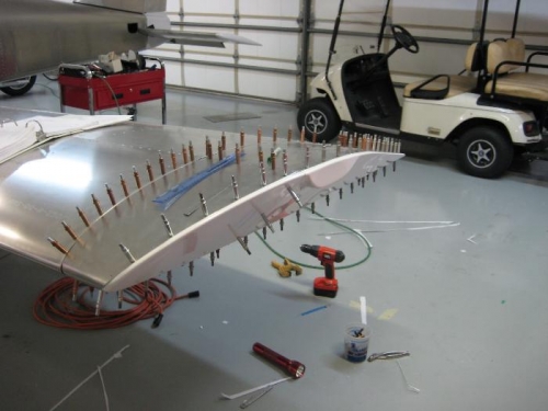

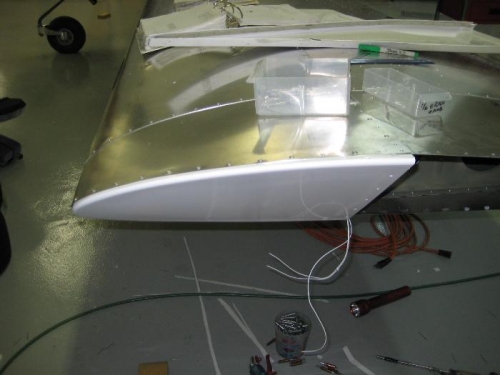

left wing tip
Removed tip trimmed and taped backing strips in place. Reinstalled tip then drilled to 30. Removed and deburred. Reinstalled and began riveting. Had to stop when I ran out of the brass backing washers for the forward tip.
