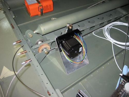

Date:  6-18-2009
Number of Hours:  4.00
Brief Description:  Pitch servo

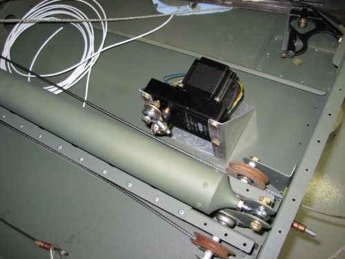

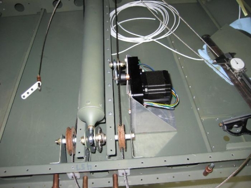

Started planing the installation of a Dynon SV32 servo to the pitch system. I was going to copy the True Trac mount and mount it to the top of the bellcrank channel. After getting the 3Lb servo I decided that it would be to much stress on the channel and bracket. I built a bracket out of .050 that will mount to the tailcone skin and I am going to build another support that comes off of the bellcrank channel. I think this will carry the weight and toqure better. This won't be the final product but I think it is close to it.
Prototype servo bracket
