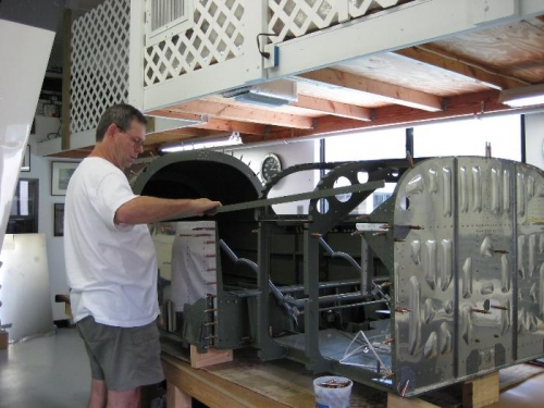

Brief Description:  Joined Forward fuselage
Fabricated forward rudder pully bushings, deburred and primed pully brackets and installed in forward fuse. Found a bellcrank support that I must have missed in the plans. Polished and primed. Will install later. Clecoed forward fuselage to center section. Added bracing and began riveting. The forward side and cowl skins will not get riveted until I am finished with all electrical,pluming and my spars have been reamed to the center section.
