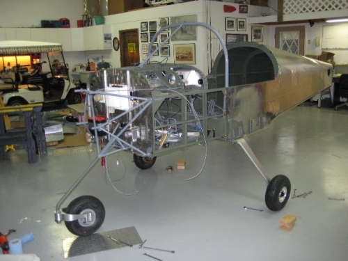

Brief Description:  Installed Landing Gear

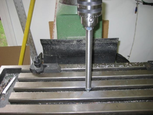

Got out the wheels and brakes. Toqured the gear legs in place then attached the main gear axles. Greased the bearings and installed the main gear wheels. Installed the nose gear leg and bolted in place. Ran a piece of 7/16 althread through the nose gear axle wirh a nut on each end and chucked it up in the mill then turned it down to fit the nose wheel bearings. About .622" will slide through with a little friction. Fabricated the side spacers. Installed nose gear.
Sanding Nose wheel axle to size
Standing on gear
Standing on gear
