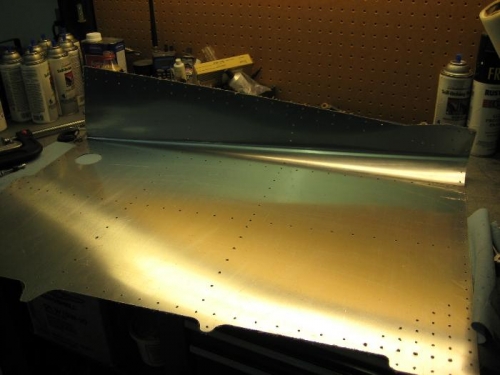

Bent right side skin

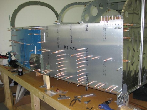

Bent up the right side skin. Had to be inventive to get it right. The bend at the rear is very sharp and probably a 2 to 2.5 inch radius at the front. Clecoed to the side and then the bottom. The holes lined up perfect .
Bent right skin
Clecoed in place
