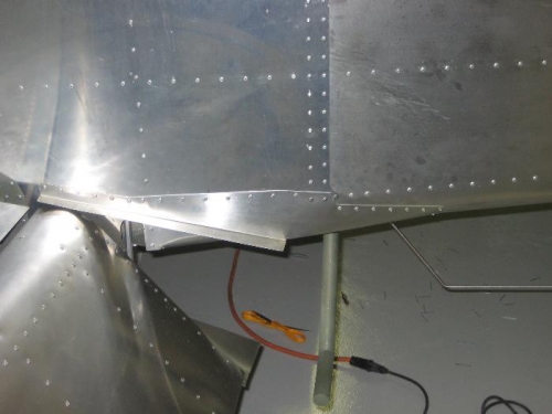

Brief Description:  Flap fillet part 3
I located the holes that I had to drill out then layed up the spacing for the rest of them. You need to mark where two rivets are located on the belly so as not to place another too close.(image 1) I then transfer drilled to 40 then 30 the rest of the holes.(image 2) Deburred primed an riveted in place.
Rivets on belly
Rivets on belly
Transfer drill
Transfer drill
Finished
Finished
