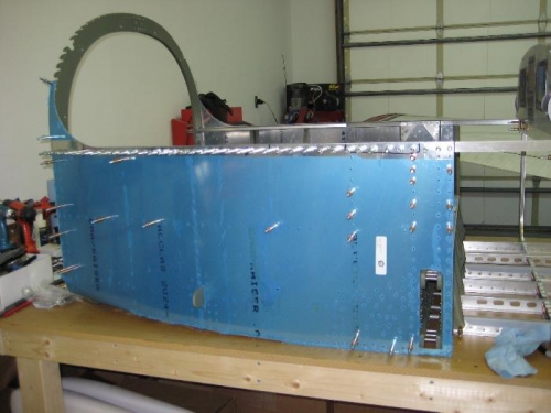

Brief Description:  Gussets and Longerons
Spent awhile figuring out where the gear angle gussets went then fabricated shims and clecoed in place. Checked longeron with template prior to transfer drilling. Reworked right longeron then transfer drilled left and right longeron. Turned center fuse up side down and located belly skin and gussets. Clecoed in place
