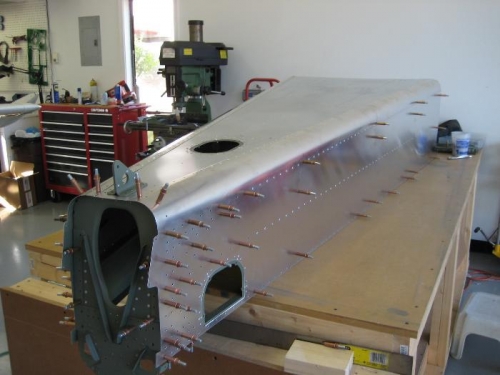

Riveted tailcone
Started riveting the tailcone together.Started on the bottom then fliped it over and did the sides and the #5 bulkhead. I will have to shim the #2, #3, #4 bulkheads on the lower holes to keep from getting a pucker between the bulkheads.
