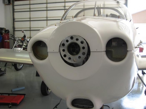

Did a little more fiberglass work on the cooling ducts. Cleaned out the needle and seat and reset the float level on the carburator, now the fuel pump doesn't overpower the needle and seat and I get good fuel pressure 1.6 lbs. Installed the fuel pump bleed line and the oil catch can. Modified the carb heat system and installed it and the cabin heat shrouds. Ordered a goose neck for the carb.
