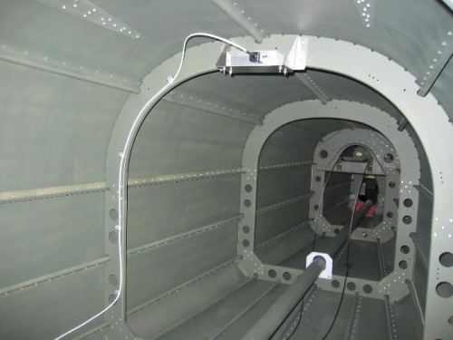

Brief Description:  Compass install
Fabricated a bracket for the electronic compass. Discovered that the 4 bulkhead is not quite vertical so I had to shim the compass 5 degrees nose down to get it level. Clamped in place and got it level then drilled clecoed and riveted in place. When all was said and done it was within 2 tenths of a degree. Secured wires in place.
