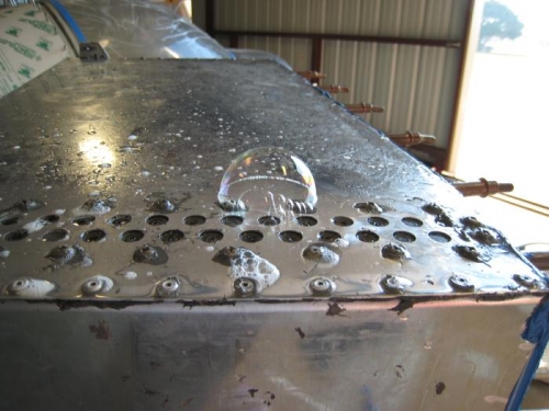

Tested for leaks and foound leaks in sight window as well as a minor one at rear top corner.
Removed tank top. Removed sight window.
Cleaned and scuffed are for lens. Coated lens area with a generous portion of sealant.
Re-assembled, but only clecoed tank top.
Ordered new rivets and screws.
