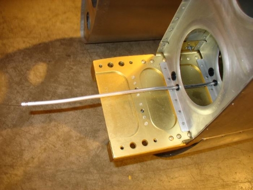

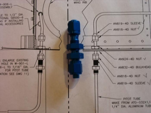

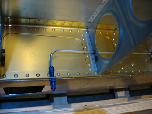

With the help of Tammy today we were able to install the pitot tube in the wing today. It was a little confusing because the plans on drawing 9 were not acurate. However with the two of us looking at it we were able to figure it out pretty well. I used the aircraft hand book to get the torque values of the nuts correct, used the pipe bender and 37 deg fluting tool for the first time. Bought a cheep fluting plier from horbor freight.... mistake. Ordering a good one from Avery in the morning before I start working on fuel system.
Drawing 9 is a not acurate
