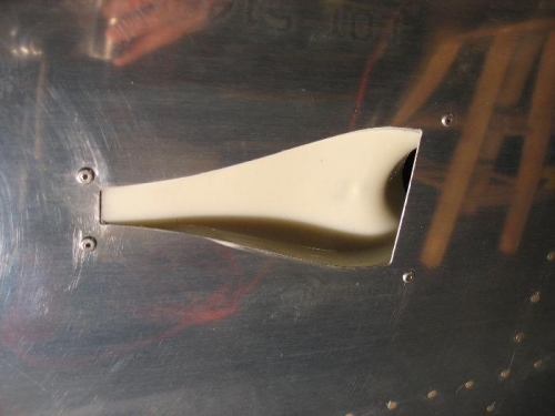

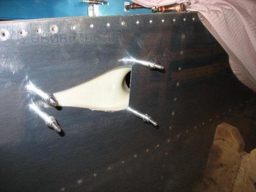

Brief Description:  Fresh air vents
Built the fresh air vents this morning. I used a silicone seal and clecos to hold it in place while it dried. As you can see I used pop rivets instead of flush rivets. This may be a mistake instead of using flush rivets, but riveting by myself can be very difficult and in the end the pop rivets will be less of a mess. I will fill them in with puddy before painting.
