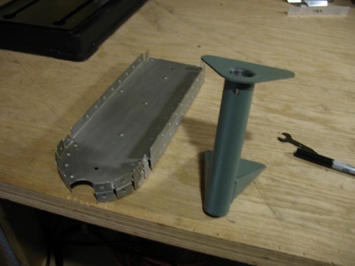

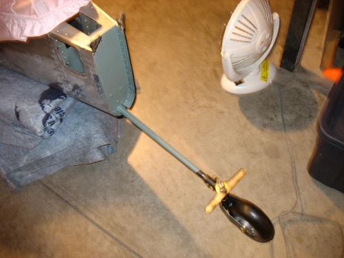

Brief Description:  Tail Wheel
Work on installing the Tail wheel assembly today. I had to remove the aft bulk head to fit the tail wheel bracket and match drill it to the fuselage. After removing the aft section the hole was cut to that the tail wheel bracket will slide into. After installing and riveting the aftbulk head back on, I realized that I forgont to put the bolt in for the tail wheel arm. However it worked out, because I had to drill a small hole to fit the nut on to the bolt, which is good because If I had not had to drill that hole the tail wheel arm never would have been able to be removed. Thinking that a nice areodynamic cover would look nice.
