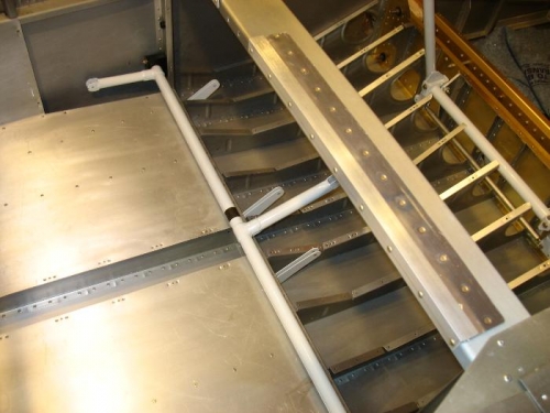

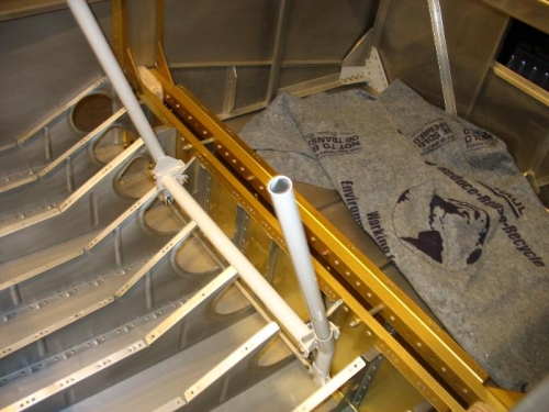

Brief Description:  control bell crank and Flaps
We installed the Flap controll rod and the nylon blocks, Pop riveted the baggage compartment Floor and installed the control bell cranks and stick. While installing the stick control rod we discoverd that the floor rib holes that the control rod passes through were way to small. So I did a little resarch and found that I needed to enlarge the holes. Thin I discoverd that the tops had to be removed to allow for proper clearance. No note of this is found in the plans but many have made post on the interenet about having to modify the ribs. A bit bummed about it.
