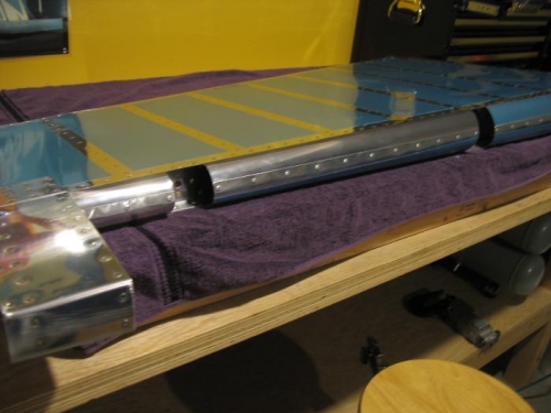

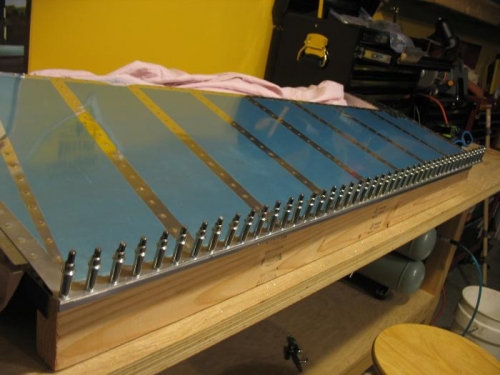

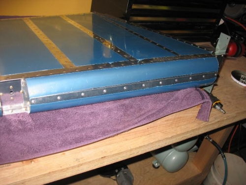

This morning I discoverd that I riveted the bottom of the rudder together with out manufacturing and installing the mounting bracket for the bottom fiberglass. Ooops.. So I drilled out all the rivets on the bottom and made the bottom bracket, and put it back together. There is an hour and a half of my life I can not get back. I also was able to roll the front leading edge tonight. It turned out ok except for a couple of little gaps in the overlap. tried fixing it a few times but to noavail it still remained. Was also able to manufacture the trailing edge clamp to begin the bonding process. I also counter sunk both sides of the Trailing edge "V" angle as well
Bottom of the leading edge
Top of the leading edge
Preping to seal trailing edge
