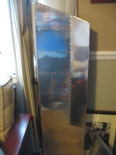

Brief Description:  Finished Left elevator and trim tab, Started Rudde
Finished the left elevator and trim tab today. Installed the hinge and attatche the Trim tab to the Left elevator. Very happy with the results. Also worked on the sharp edges by filing them down and closed a small gap in the trailing edge of the elevator. Also started the Rudder this afternoon. Manufactured all the Stiffners, cut, Matchdrilled, deburred and dimpled. Also Pre drilled and dimpled most of the Left elevator skin that could be reached by the Squeezer. I will have to use the "C" clamp dimpler and hamer on the rest. Images to follow.
