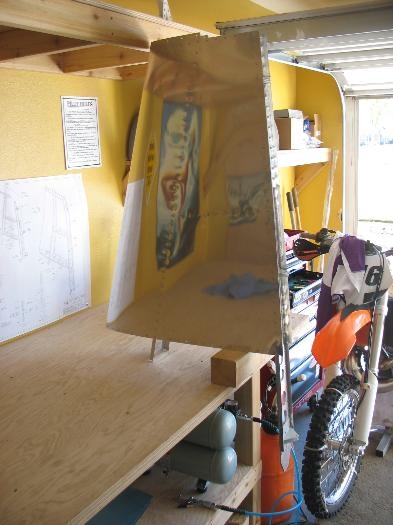

Date:  9-11-2012
Number of Hours:  4.00
Manual Reference:  6
Brief Description:  Assembly of VS
Assembled VS. Went together well accept for the riveting of the VS Bottom rib to the Spar and Spar doubler. Pnumatic squeezer and the rivet gun were both tight fits, so I ended up spliting the rivet, so I had to drill them out and replace them with blind rivets. I will consider removing those and trying again at a later date before attaching the VS to the fuselage.
