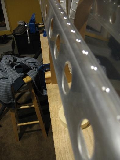

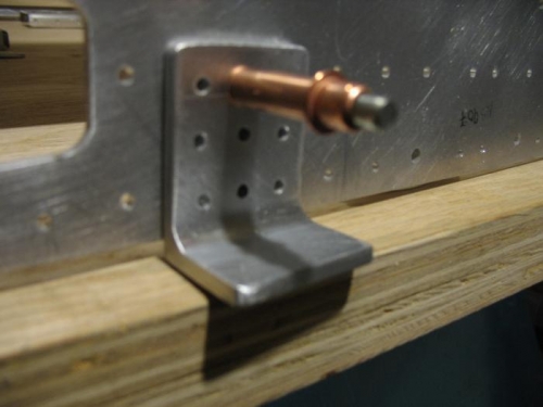

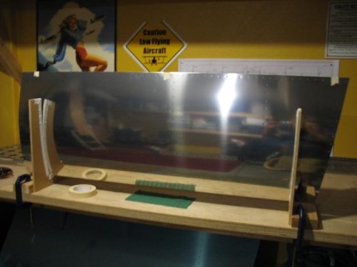

Made dimpling table, jigs for HS. also assembled Left HS and pre drilled forward and rear spar as well as HS 905 904. and HS skin. deburred all parts and dimpled HS 904 905 and Spars. manufactured HS 908R but was not happy with the results and reorderd new Angle stock to try again. do not use a jig saw to cut aluminum parts. Also pre drill one HS 908 with a # 40 and match drill with the other 908 to get the same hole pattern and then bore to #30.
