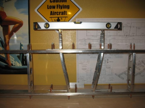

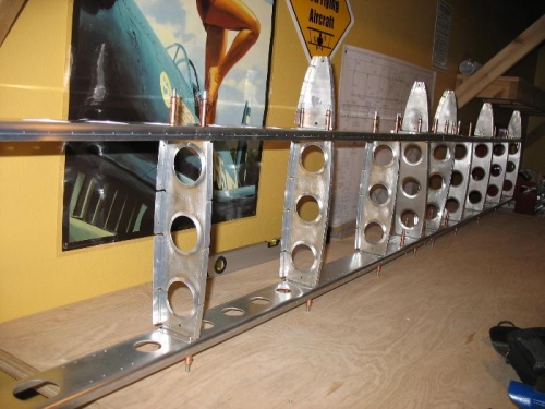

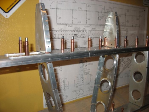

Brief Description:  Drilling and first assemble of HS frame
Drilled all 1/8 th holes to # 30 for HS sub frame. The next step is to manufacture the HS 908 R-L and match drilling to the forward spar and support. HS 912 have been match drilled and labled to be replaced in the proper spot. I will begin labling parts so I can replace them in the correct spot upon reassembly.
