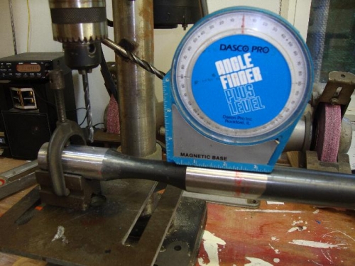

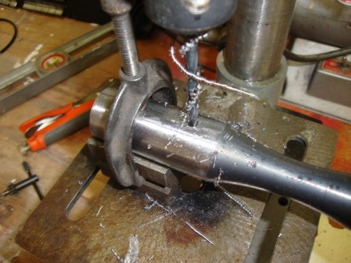

Set up and drilled gear leg to # 11, then enlarged to 1/4". Through drilled socket to 1/4" with gear leg installed.
Setting up to drill gear leg.
Drilling on mark.
Drilling gear leg
