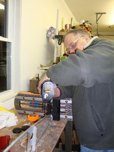

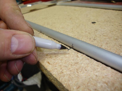

Measured and marked location of rivet holes on wing ribs that will be used to fasten fabric to ribs. Marked measurments on original wing rib jig and then transfered to ribs by lying ribs into rib jig. Click punched & drilled all rivet holes & deburred..
Marking rivet hole locations on ribs

drilling holes
drilling holes
