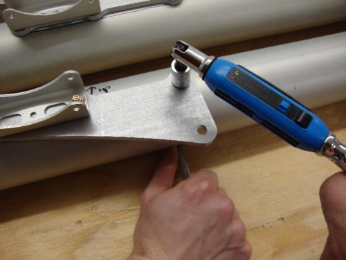

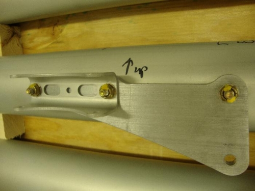

Continued installing spar plates & anti crush bushings. Trimmed bushings flush with spar OD. Torqued bolts as per AC43.13-1B table 7-1 & torque sealed.
Torquing Spar plates
torque seal
