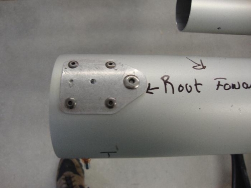

Brief Description:  Wing Frames
Installed, deburred & riveted leading edge pach on spars.Installed doubler at 50" from root end. Locate drill, deburr and install all brackets for wing compression tubes. Drill strut attach brackets for tight fit on 1/4" and 5/16" AN bolts. Drill spars for 3/8" anti crush spacers, check length. Install bushings & spar plates
Leading edge patch
Leading edge patch
