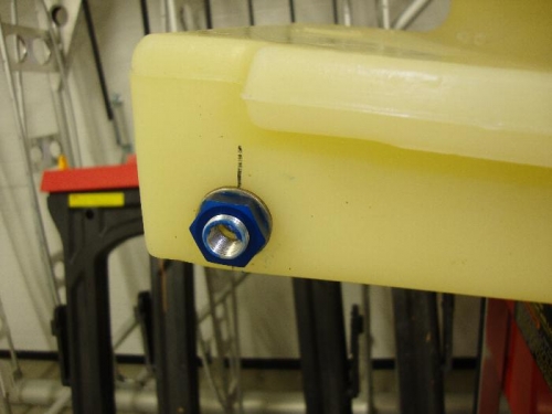

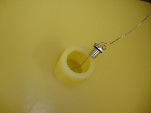

Assembled Fuel tank fittings per figures 05-14. Measured, drilled, installed fuel withdrawal fittings, orings, & nuts. Loctite nuts with blue loctite. All fittings installed in fuel tank. Next step is to pressure test & season w/fuel
Threading fitting thru hole
Fitting installed
