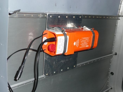

Installed the ELT on right side longerons behind baggage compartment. The antenna was mounted behind the roll bar on the right side, also. This will give it reception through the rear plexi.
I used the SV-D1000 cut out from the panel to fabricate the mounting plate for the ELT. Every aluminum scrap has a purpose!
