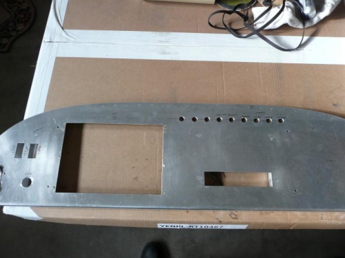

Dynon SV-D1000 arrives, along with Transponder, GPS, ELT, EMS, Probes, etc. Made some more cutouts on panel and center console. Installed plate nuts on back of panel for Skyview. Made cutouts for Batt/Alt switch, ignition switch, ELT remote panel and several toggle switch holes.

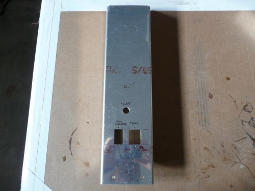

The center console will hold the elevator trim switch and indicator, flap switch, perhaps a couple of 12v receptacles. Also plan to run some harnesses behind the console to the avionics bay.

More Dash cutouts
More Dash cutouts
Center Console
Center Console
