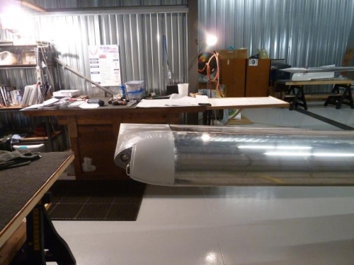

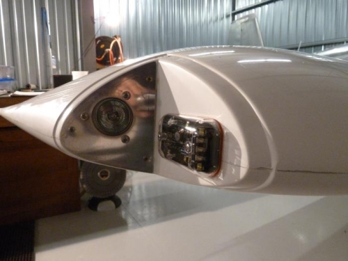

More work on wingtips. I riveted the aluminum backing strips to the wingtip. Installed the position/strobe and landing lights. I used velcro to attach the Nav antenna on the bottom surface of the wingtip. Attached the wingtip to the wing with #6 stainless screws.
Right wingtip installed
Landing and Pos/Strobe
