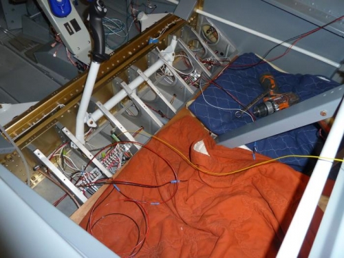

Brief Description:  Wing wiring
Pulled wiring into cockpit from both wings. I managed to get most of the wiring from the right wing installed and secured to the terminal blocks located underneath the seat panels. Will have to do the left side connections next. Then will begin securing wiring from there up through to the panel and forward bulkhead areas.
Wing wiring pulled into cockpit
