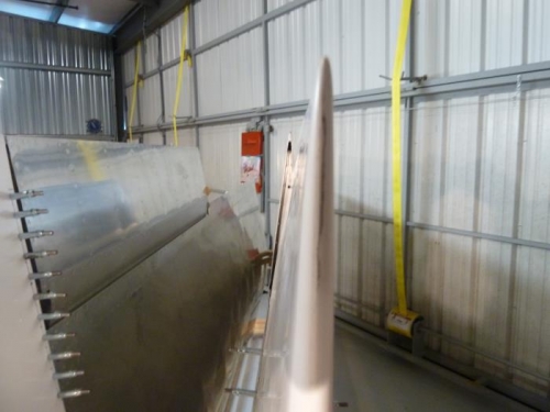

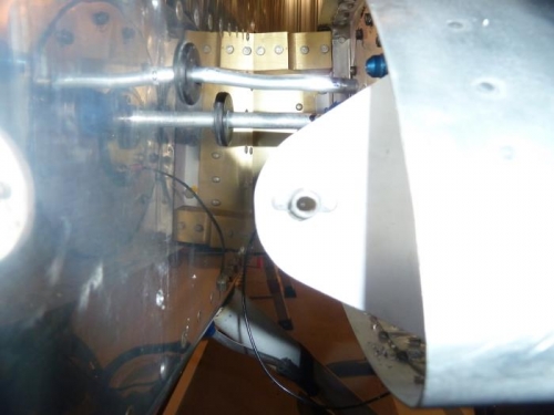

I have worked several days installing ailerons, fitting wingtips and doing all the prep work to reinstall wings permanently, More work is needed. Aileron outboard brackets appear to need slight (1/8" or so) movement to align with wing and tips. Also found one inboard bracket rubbing against a rivet on the wing mounting bracket. Will have to drill rivet out and replace.

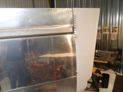

When installing the left wingtip, I found that the tip construction is no quite right. I will have to cut a wedge piece out of the aft bottom section of the tip and re-glass it to get a good fit and alignment with the aileron.
So, a few more hours of work before permanent wing installation. Tips can be worked on after the wings are installed at this point.
Left frontTank bracket
Right tip fits good
Right tip fits good
Bad fit on left wingtip
