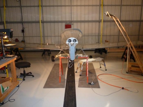

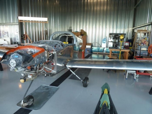

Today was wing install day. Thanks to the help of Paul, Phil, Jim T and Mike, all went well. Wings were slipped into the center section and pinned in about 15 or 20 minutes. The rest of the time was spent getting the wings set. All that was accomplished. Drilled the rear spar attachments and pinned them; then called it a day.
Front tank to fuselage brackets will have to be fitted; wing gap fairing fitted and drilled; then pull the wings to attach all the hardware to wings and fuselage. Fuel line fitting can then be put on before re- installing the wings permanently. Also will probably fit the wingtips before wings go back on.
