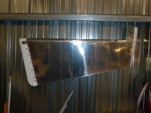

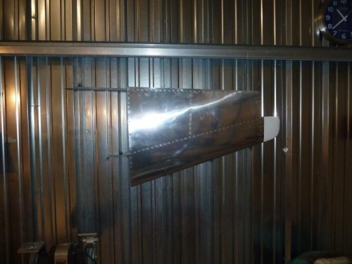

Hung the VS, rudder and ailerons on the hangar walls to free up some workspace.
Ailerons
Ailerons
Vertical Stabilizer
Vertical Stabilizer
