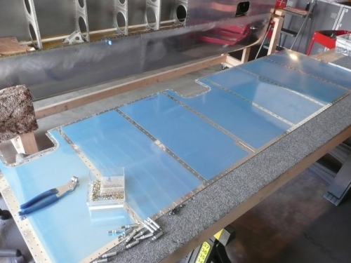

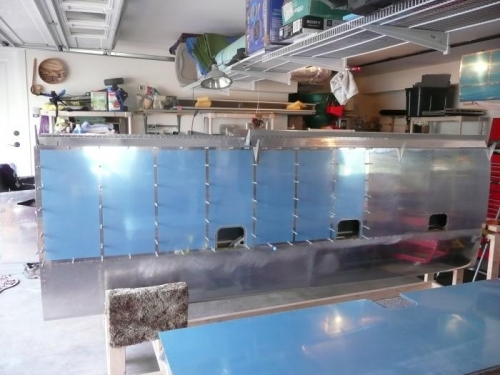

Brief Description:  Wing Bottom Skins
After a nice vacation to PA to visit family, I am finally getting back to a little more RV work.
May 14, 16, 17 were spent working on the bottom wing skins. This meant match drilling, deburring and dimpling/countersinking over 1000 holes in the skins, inspection covers, spars and ribs. I also primed the inside of the skins. I now have them about ready for riveting; however, I will be moving them to a friend's hangar for storage. I will rivet them at a later date.
I need the wings out of my garage to make room for the Finishing kit items and also have more room for installation of the Finishing kit pieces.
