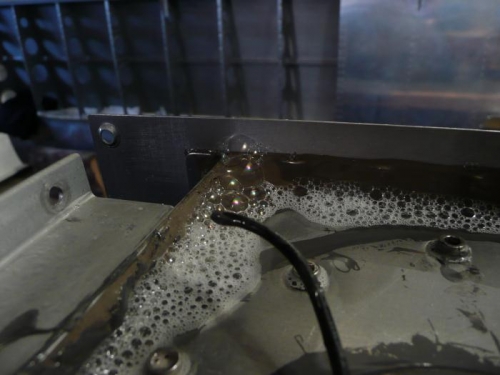

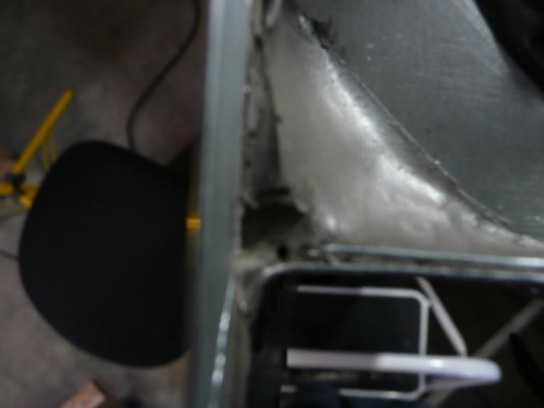

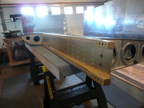

Removed the left tank today and found the leak at the top corner where the skin, rear baffle and inboard rib meet. Trimmed the proseal and found many air holes in the mixture.
Will have to look into this further after Christmas trip.
Left tank removed
Leak Found
Top corner proseal with many holes in sealer
