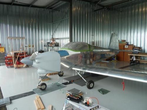

Brief Description:  Aircraft Weighing
PIcked up the scales from EAA Chapter 326 in Puyallup yesterday. Finished the weigh-in today with help from Paul Westcott and Phil MIchel. I was very pleased with the end result - 1067 pounds. Right main - 397; Left main - 395; and Nose wheel - 275. Forward Empty CG is 76.18. This works out great in several different loading scenarios.
Weigh In completed
Weigh In completed
