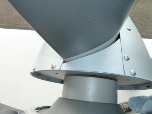

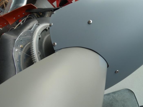

Fabricated two propellor gap seals. I had to remove the prop and fore and aft plates to 1) allow access to rivet the gap seals onto the plate, and 2) to prime both plates before re-install. I installed the gap seals, plates, prop and re-torqued the bolt; following up with safety wire.
Spinner gap seal
Spinner gap seal
Spinner cut out
Spinner cut out

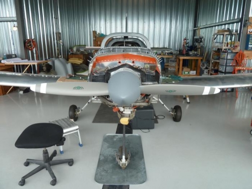

And there it is!
And there it is!
