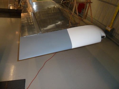

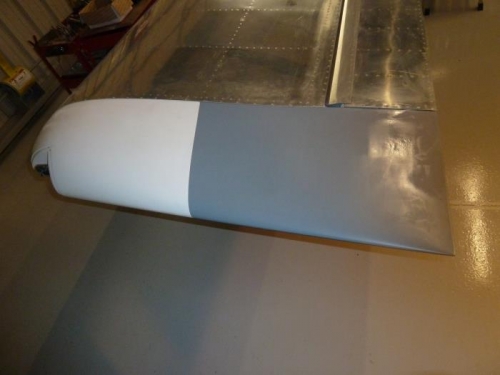

Primed both wing tips where riveting and fiberglass work had been.

left wing tip
left wing tip
right wing tip
right wing tip
