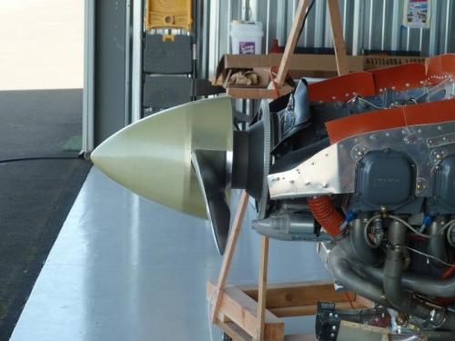

Layed up some fiberglass around the inside perimeter of the spinner and clecoed in the forward plate to let dry. Covered the contact area of the plate with wax to prevent adhesion.
Safety wired two alternator bracket bolts after torqueing. Applied some finish putty on the left wingtip.
Fitting the Spinner
Fitting the Spinner

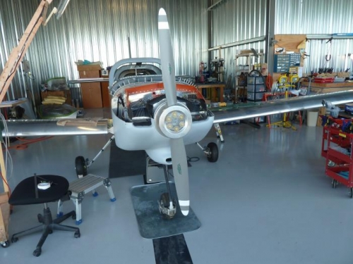

Spinner plates and prop installed
