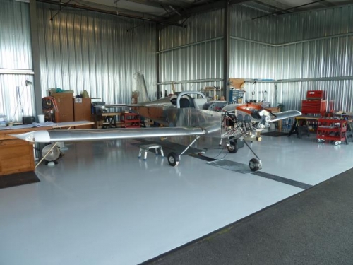

Worked on attaching fasteners for empannage gap seal. Also replace 6 AN fitting on brake system; 4 in park brake and 2 on lower outlet of master cylinders. Have been have a problem with sealing up the 1/8th pipe threads. This time, I sealed with Loctite 567 and hope it works.
Spent some time with the hangar door up/open and enjoyed the sun while doing some hangar cleaning.
