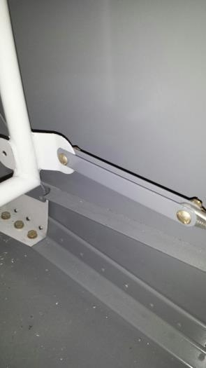

Also made connecting pieces to connect rudder cables to rudder pedals. These were 4 inches long to allow for the forward most position of the rudders. Rudder controls can be moved aft in 3 more locations approximately in 1 inch increments which will require shorter connectors to the cables.

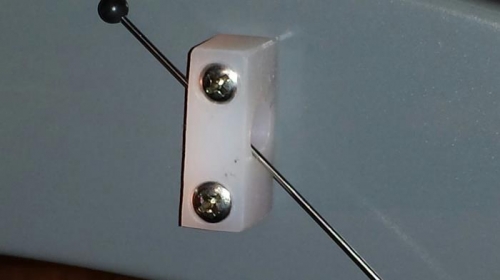

Fabricated and installed ELT antenna hold down on the aft side of the roll bar.
Elt antenna hold down
Rudder cable connectors
