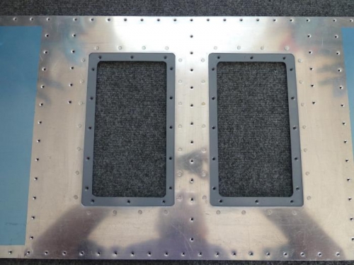

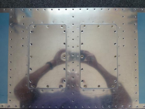

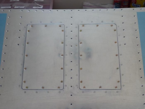

Installed 2 inspection panels in the Forward Fuselage immediately behind the firewall. These are not in Van's plans; however having see other builders install these gave me the idea. It will make access to forward wiring and components much easier. Canopy release can be reached here also. This will be the last skin to be installed on the Fuselage.
Nutplate rings
Nutplate rings
Covers installed
Covers installed
