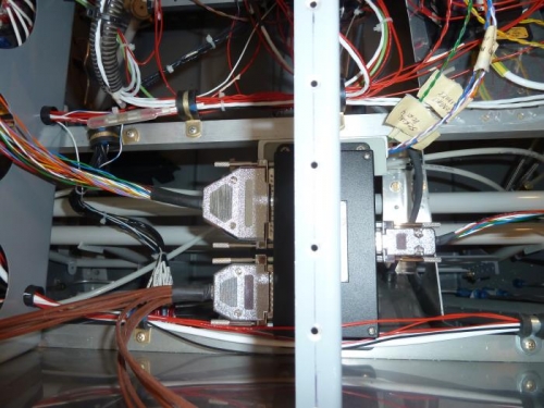

I remounted the EMS 220 from where I originally installed it on the right side just behind the Panel. I wanted to leave that area clear to accomodate any future avionics that might be installed. I ended up mounting the EMS in the center, just aft of the firewall. I will be installing two inspection panels in center of the forward skin for easier access the EMS and any other wiring that one may need to access in the future.

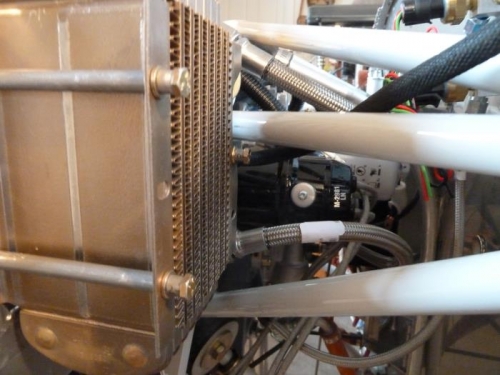

I mounted the oil cooler and attached hoses. I installed the 4 CHT and EGT sensors. I hooked up the SV Tach wires to the ignition switch where the L & R P leads attach. A 30 Ohm resistor is attached to each position also. Pulled all the sensor wiring from the EMS through the firewall pass thru fittings.
New mounting for EMS 220
Oil Cooler Installed
