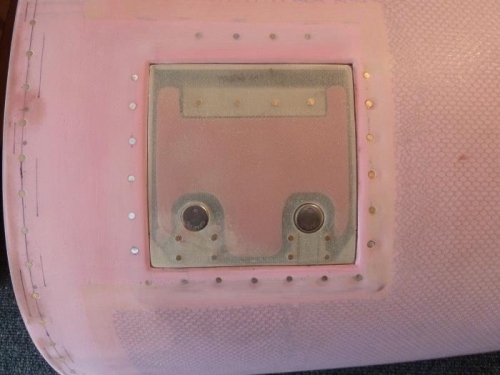

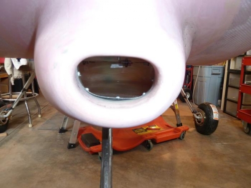

Brief Description:  Finishing Air Scoop opening

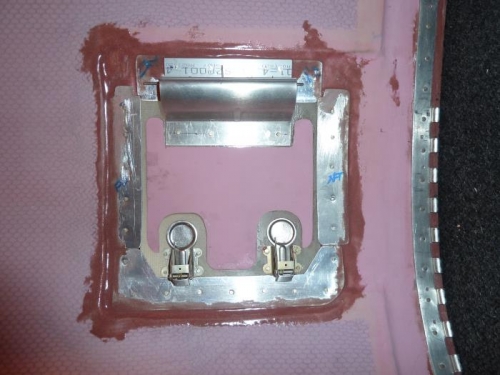

Finished the work on the air intake today. I also worked on the oil door in the top cowling. I reinforced the perimeter of the opening with .025 aluminum and fiberglassed it in. The metal edges seemed to be better for the latches to attach to and should last longer.
Finished air intake
Finished air intake
Oil Door inside view
Oil Door Top View
Oil Door Top View
