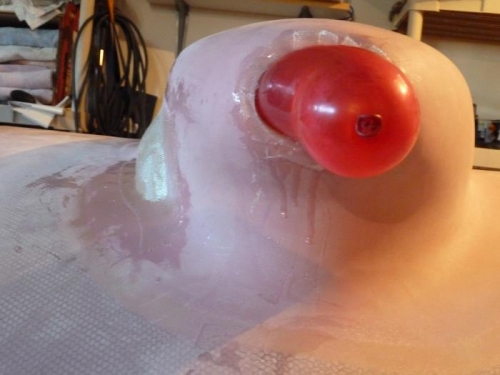

Extending the cowl air inlet

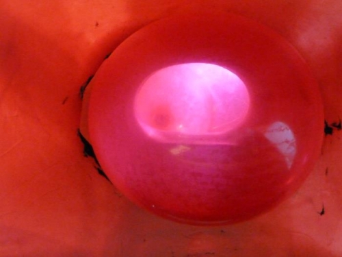

Installed 3 layers of fiberglass cloth to inside of air inlet and secured with balloon method suggested by Van's Aircraft.
The balloon trick.
Inside view
Exterior view
