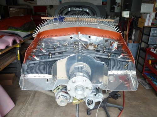

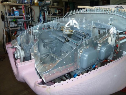

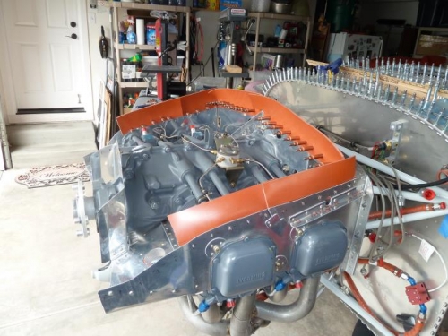

Finished up trimming of metal baffles. Installed aft end and side material on trimmed baffles. I used a silicone rubber material from Aircraft Spruce It is supposed to be less abrasive on the inside of the fiberglass cowl under operation conditions. The material also is supposed to take a shape after flying for a few hours which will make taking the cowl on and off a little easier.
Ready for baffle material
Using silicone rubber seals
Side view
Side view
