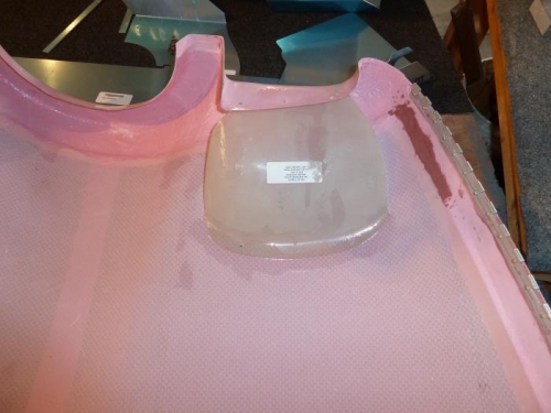

Installed the air inlet ducts on the upper cowl. Roughed up all the fiberglass. Drilled holes, added resin, clecoed the ducts to dry overnight.
Glassed in air inlet ducts, right side
Left side duct
