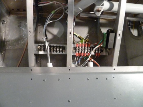

I installed 2 SafeAir Pass-Thru fitting for all the wiring that needs to go from engine side of the firewall, through the firewall into the cabin side. These are specially made for aircraft; a little expensive, but make a nice hook up. I also grounded the shields from the radio equipment and added a second junction block under the pilot side floor.
Added 2nd Junction Block
