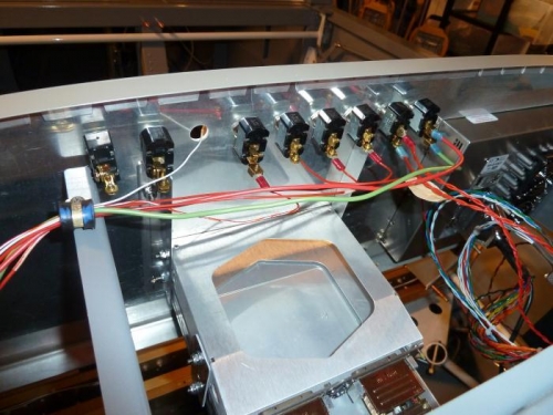

Worked on wiring again today. Installed some switches and wiring. All electrical systems will end in a common ground location inside the firewall. This is supposed to minimize any electrical noise interference throughout the aircraft, such as headsets, radios getting noise from alternators, starters, Auto pilot motors, etc.

Switches and Audio Panel tray

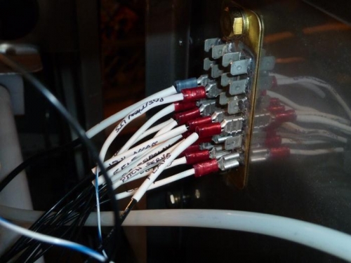

Common Firewall Ground termination
