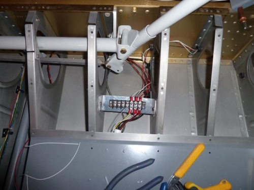

Control Stick wiring
Wired up the control sticks today. Pilot will have PTT, A/P disconnect, Com frequency Flip/Flop, and Elevator Trim on the Hat Switch. There are still 2 positions on the Hat Switch and one position for ??. Co-pilot will only have PTT for now.
Wired Stick controls
Only PTT wired on this side
