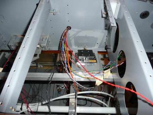

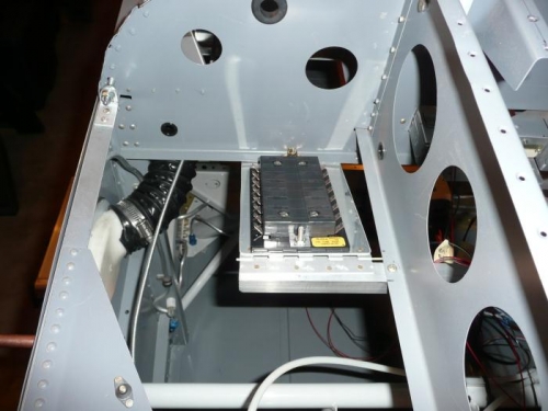

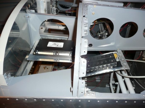

I have installed a Main fuse block and an Avionics fuse block between the firewall the center bulkhead. I have made them able to "drop down" for easier access from the cockpit.
The EMS module location behind the panel on the right may or may not be the final resting place. It needs to be close enough to the engine for all the sensor wires to reach their attachment spots. Also, I might like to leave that area behind the panel clear in case I add more avionics on that side of the panel.
Possible EMS Module Location
Main Fuse Block
Main Fuse Block
Avionics Fuse Block
Avionics Fuse Block
